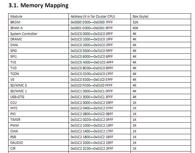

非常简单, 就是把协处理器的寄存器读到 R0, 没别的功能.
MDK工程,读芯片Id, 代码不到10行,没有中断向量.
: 这个代码只能在 N3290x 上面跑, 因为N3290x 的SRAM地址在 0xFF00 0000,
全志f1c100s的sram地址在 0x0 位置。

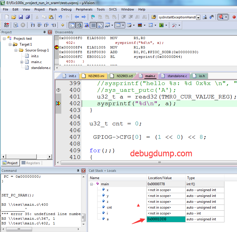

楼主 #5 2018-08-20 11:58:01
已发帖子: 9,473
Re: step by step 全志 f1c100s MDK 裸奔各种外设(参考N3290x)
  sys_clock_init();
  sys_uart_init();
	write32(TMR0_INTV_VALUE_REG, 0x2EE0);   //Set interval value
	write32(TMR0_CTRL_REG, 0x14);   //Select Single mode,24MHz clock source,2 pre-scale
	write32(TMR0_CTRL_REG, read32(TMR0_CTRL_REG)|(1<<1)); //Set Reload bit
	while((read32(TMR0_CTRL_REG)>>1)&1);  //Waiting Reload bit turns to 0
	write32(TMR0_CTRL_REG, read32(TMR0_CTRL_REG)|(1<<0));  //Enable Timer0
  while(1)
		//sysprintf("hello %s: %d 0x%x \n", "world", 10, 20);
    //sys_uart_putc('A');
		u32_t a = read32(TMR0_CUR_VALUE_REG);
		sysprintf("%d\n", a);
实现timer0 定时器累加简单demo: f1c100s_project_run_in_sram_5.7z

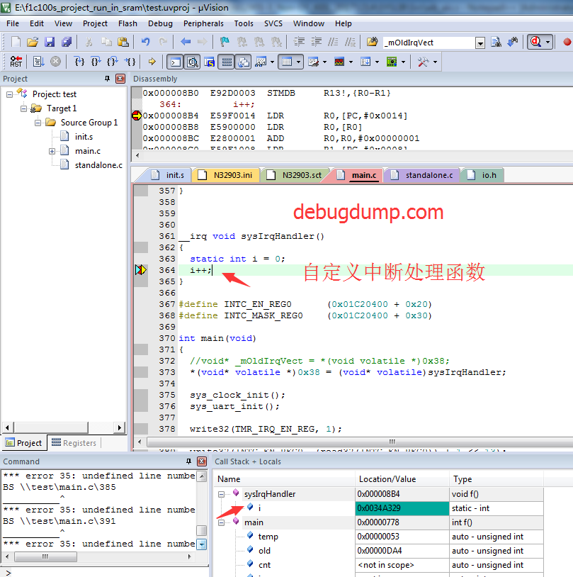

楼主 #6 2018-08-20 16:54:43
已发帖子: 9,473
__irq void sysIrqHandler()
	static int i = 0;
	i++;
#define INTC_EN_REG0			(0x01C20400 + 0x20)
#define INTC_MASK_REG0		(0x01C20400 + 0x30)
int main(void)
	//void* _mOldIrqVect = *(void volatile *)0x38;
	*(void* volatile *)0x38 = (void* volatile)sysIrqHandler;
  sys_clock_init();
  sys_uart_init();
	write32(TMR_IRQ_EN_REG, 1);
	write32(INTC_EN_REG0, (read32(INTC_EN_REG0)) | 1 << 13);
	write32(TMR_IRQ_EN_REG, (read32(TMR_IRQ_EN_REG)) | 1 << 13);
	write32(TMR0_CTRL_REG, 0x10);   //Select Single mode,24MHz clock source,2 pre-scale
	u32_t temp;
	__asm
		 MRS    temp, CPSR
		 AND    temp, temp, 0x7F
		 MSR    CPSR_c, temp
	u32_t old = 0;
  while(1)
		volatile u32_t a = read32(TMR0_CUR_VALUE_REG);
		if(old == a)
		else
			old = a;
			if(a % 256 == 0)
  u32_t cnt = 0;
   GPIOG->CFG[0] = (1 << 0) << 8;
  for(;;)
    if(cnt==0)
      GPIOG->DAT &= ~(1U << 2);
    if(cnt==100000)
      GPIOG->DAT = 1U << 2;
    if(++cnt>200000)cnt = 0;
	int i = 0;
	while(1)
		i++;
实现了定时器中断的简单demo: f1c100s_project_run_in_sram_6.7z
仍然感谢新唐提供的裸奔程序。

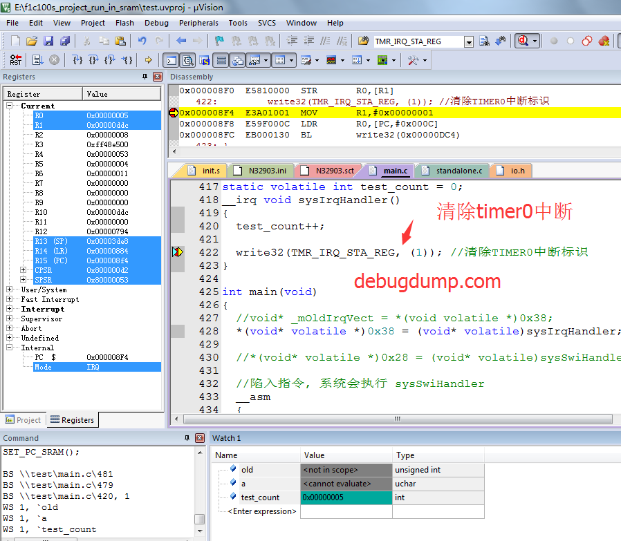

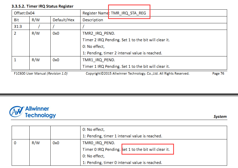

楼主 #9 2018-08-22 14:03:43
已发帖子: 9,473
#define TMR_IRQ_EN_REG 			(0x01C20C00 + 0x00)
#define TMR_IRQ_STA_REG 		(0x01C20C00 + 0x04)
#define TMR0_CTRL_REG 			(0x01C20C00 + 0x10)
#define TMR0_INTV_VALUE_REG	(0x01C20C00 + 0x14)
#define TMR0_CUR_VALUE_REG	(0x01C20C00 + 0x18)
#define INTC_PEND_REG0		(0x01C20400 + 0x10)
#define INTC_PEND_REG1		(0x01C20400 + 0x14)
#define INTC_EN_REG1			(0x01C20400 + 0x24)
#define INTC_MASK_REG1		(0x01C20400 + 0x34)
#define INTC_RESP_REG0 		(0x01C20400 + 0x40)
#define INTC_RESP_REG1 		(0x01C20400 + 0x44)
#define INTC_FF_REG0			(0x01C20400 + 0x50)
#define INTC_FF_REG1			(0x01C20400 + 0x54)
#define INTC_PRIO_REG0 		(0x01C20400 + 0x60)
#define INTC_PRIO_REG1 		(0x01C20400 + 0x60)
static volatile int test_count = 0;
	test_count++;
	write32(TMR_IRQ_STA_REG, (1)); //清除TIMER0中断标识
int main(void)
	*(void* volatile *)0x38 = (void* volatile)sysIrqHandler;//设置IRQ中断处理程序
	sys_clock_init();
	sys_uart_init();
	write32(TMR0_CTRL_REG, 0x10);   //此行注释有误,具体看手册 Select Single mode,24MHz clock source,2 pre-scale
#if 1
	//开启中断使能
	u32_t temp;
	__asm
		 MRS    temp, CPSR
		 MSR    CPSR_c, temp
	u32_t old = 0;
	while(1)
		if(old == test_count)
		else
			old = test_count;
			if(test_count % 256 == 0)
				sysprintf("%d\n", test_count);
跳出七七四十九道坑写的TIMER0 中断处理程序:
f1c100s_project_run_in_sram_8.7z

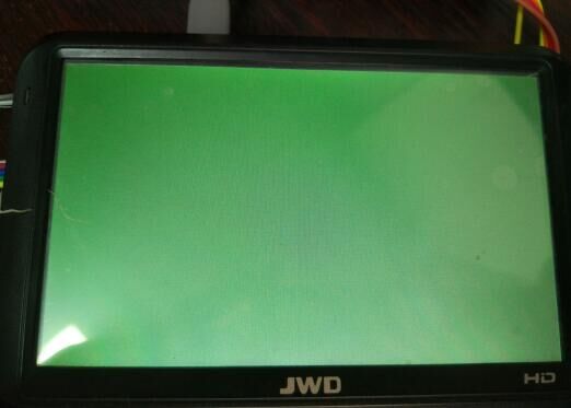

楼主 #16 2018-08-28 19:22:25
已发帖子: 9,473
@达克罗德 大神方便帮我看下楼上的MDK工程吗,
调用ddr初始化代码lcd就显示不正常了,
只有把你的工程编译烧到spi flash,
让他初始化ddr,
才能正常LCD显示。

'调用ddr初始化代码lcd就显示不正常了',你这时flash中的程序是否先初始化了还是flash是空的?
如果是flash中的程序已经初始化过一次了,那么dram_init有可能不能调第二次了,因为它好像是靠多次试探出的参数
如果flash为空然后你调用ddr初始化代码却不能用,这就比较奇怪了,我比较了代码,是和xboot几乎一样的,除了sdelay函数。你的sdelay好像只有一个nop,而原来的是loops次循环,是不是这里导致的问题。。。

我这个工程和 xboot 的初始化代码不一样,
还有这个代码直接通过 MDK 的调试按钮,下载到 SRAM 里面调试.
  1. 如果 main 函数这样 (清除了flash):
int main(void)
sys_clock_init();
sys_dram_init();
sys_dram_init() 每次都可以初始化通过,
但是 sys_dram_init() 执行过后把 SRAM 的很多处数据都改了,
也没有跟踪到到底哪行代码作怪,
因为数据被改,这样就出现了非法指令,进入了错误中断.
  1. 代码改成这样(清除了flash):
int main(void)
#if 1
arm32_interrupt_disable();
arm32_mmu_disable();
arm32_icache_disable();
arm32_dcache_disable();
sys_clock_init();
sys_dram_init();
情况和1 一模一样.
  1. 如果第一次用1的方法代码初始化DDR, 程序飞了,停止调试。屏蔽DDR初始化那一行代码
//sys_dram_init();
程序可以正常运行了,循环写帧缓冲区也没有问题, 但是屏幕只显示淡蓝色, 一直都是淡蓝色.
实际上中断程序,看颜色变量是正常的红绿蓝颜色.
  1. 如果按上面方法, 把xboot 的 bin 烧录到 flash(只有ddr 初始化,然后进入死循环), 然后再用MDK SRAM调试,
int main(void)
sys_clock_init();
//sys_dram_init();
代码中不再有 DDR 初始化相关部分, 那么运行正常, 可以蓝绿红切换屏幕.
#20 2018-08-29 08:42:36
arm32_interrupt_disable();这个可能是能通过的原因,因为xboot调dram初始化前是关中断的
sys_dram_init();会改0x5c作为重入标志,其它按理不会改SRAM了。你看看0x5c是不是重要位置

弱弱的问一下,F1C100S的sram地址怎么是0?我在文档上没找到呀
#66 2020-05-15 17:14:11
kq851211
注册时间: 2020-05-01
已发帖子: 49
积分: 34.5
我只在文档上发现这个。不过是 Allwinner_F1C200s处理器用户手册 里的。应该和F1C100s是一样的吧

哪位大神能否解释下为什么sram地址是0?文档上0地址不是BROM吗?
#68 2020-05-16 14:19:35
LinjieGuo
注册时间: 2019-07-24
已发帖子: 592
积分: 595
全志F1C100s这款芯片是ARM926内核,通过学习其启动流程,可以知道bootloader的原理。可是由于资料的缺少,以至于,我对于它的启动流程,也只是猜测,并未发现有比较严格的描述。因此对于这个芯片的启动流程,任何回答,我认为都不严谨,但是不影响我们对其进行学习和开发。这部分,比较难以描述清楚,只能通过提问-回答的方式来描述。
(1)芯片上电后,做什么事情呢?
F1C100s上电后,芯片内部接通BROM,执行BROM里的程序。
==>BROM里的程序做什么事情呢?
①检查SDIO接口挂接的存储器是否存在有效魔术头。存在,则根据魔术头加载此存储器的程序,并执行。否则执行下一步。
②检查SPI接口挂接的存储器是否存在有效魔术头。存在,则根据魔术头加载此存储器的程序,并执行。否则执行下一步。
③检测不到有有效程序,芯片就进入FEL模式。
==>魔术头是什么呢?
魔术头应该是96字节的一组数据,里面描述了用于SPL相关信息,用于给BROM识别存储器是否存在有效程序。其中包含了,程序的体积,运行地址,等数据。
==>FEL模式是什么呢?
进入FEL模式,我们可以使用软件sunxi-tools通过USB给芯片下载程序到flash等存储器中。
==>芯片如何跳转到用户程序入口呢?
根据本教程对此问题作答,BROM识别到SPI Flash存在有效程序后,会根据魔术头的内容加载SPI Flash里的数据,到芯片的SRAM0中。
注意,这一块SRAM0位于0X00000000地址处,与BROM地址重合,在BROM启动加载代码时,BROM已经失效。也就是说,我们的程序是无法访问BROM的,只能访问BROM失效后的,并且地址与BROM重合的SRAM0。加载完之后,跳转执行。跳转到什么地方执行?不知道,理论上是0X00000000地址,然后执行复位异常的代码。
由于SRAM0的空间有效,非常小,应该只有45KB左右(理论上是32KB,但是经过测试,可以用45KB)。所以,加载进SRAM0的代码需要负责把体积大的程序复制到DRAM里面,然后跳转过去执行。
这个流程描述的非常模糊,可以这样表示:
·BROM里的程序负责加载bootloader到SRAM0,然后跳转执行。
·bootloader程序负责加载APP到DRAM,然后跳转执行。
有可能APP的体积非常大,加载过程很久,所以可以在加载APP之前,显示产品Logo。
最近编辑记录 LinjieGuo (2020-05-16 14:20:16)

清楚了,谢谢。
@晕哥
timer0中断问题
//void _mOldIrqVect = (void volatile *)0x38;
(void volatile )0x38 = (void volatile)sysIrqHandler;
这个何解?是作为中断矢量0x38吗?
我程序在SDRAM中运行,不能进中断,一运行PC就停在0x00000004处
@晕哥 TIM0的中断源不是0x0034吗,怎么程序写的是0x38
#123 2023-09-01 23:12:30
Lunasama
注册时间: 2023-01-10
积分: 24
找了一下问题,我之所以在0x34能进IRQ是因为我在写SPL的时候瞎折腾搞出的问题:P
LCD能显示常吗,这边只有背光
