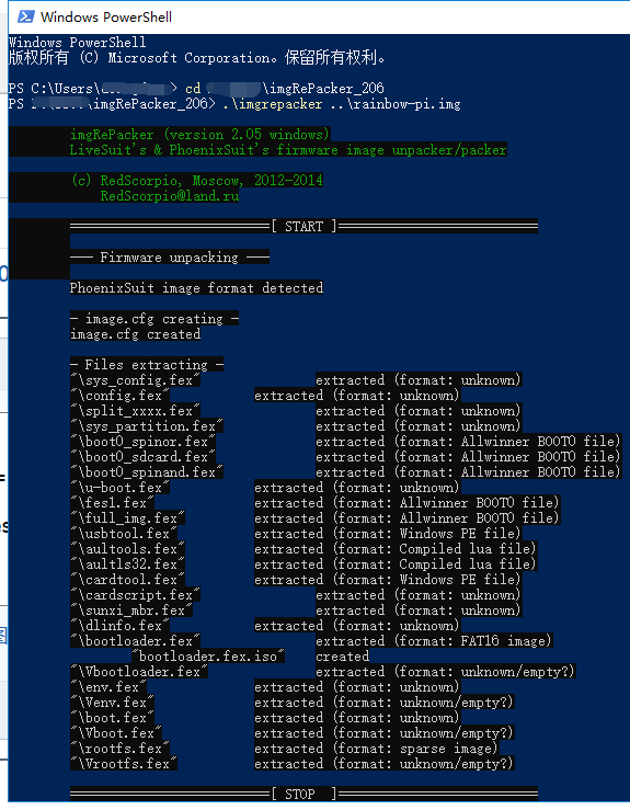

终于找到一个能用的软件了: imgRePacker_206.zip
imgRePacker
LiveSuit's & PhoenixSuit's (Allwinner) firmware images (*.img) unpacker/packerVersion 2.06 Windows & Linux
Supported firmware images (known):
Sochip SC8600/SC9800 (LiveSuit/zdisk);
Boxchip F10/F15/F16/F20 (LiveSuit/zdisk);
Teclast T7200/T8100 (LiveSuit/zdisk);
Allwinner F10/F13/F18 (LiveSuit/zdisk);
Allwinner F1C100/F1E200 (LiveSuit);
Allwinner A10/A13/A10s (LiveSuit);
Allwinner A20/A31/A31s (PhoenixSuit);
Allwinner A80 (PhoenixSuit).
Supported second layer file formats:
Android boot image;
gzip/cpio archive file;
cpio_ascii_new archive file;
sparse image (unpacking).

这个工具好用, tina3.5的img可以正常解包.
