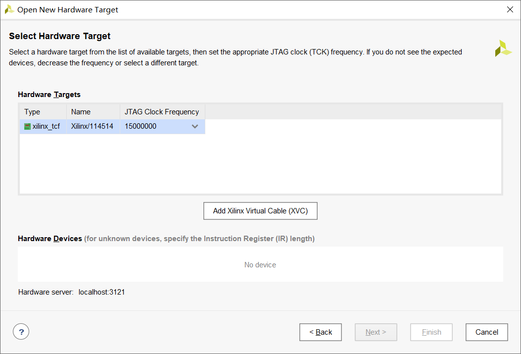

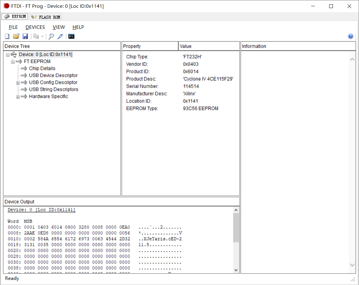

好消息,Xilinx放出了FTDI下载器的制作工具
原帖见Programming FTDI Devices for Vivado Hardware Manager Support,注意需要安装最新的Vivado 2022.1。
使用方法很简单,亲测可行。支持FT232H/FT2232H/FT4232H。
最后贴一下命令的使用方法:
program_ftdi
Short Description
Write/Read to FTDI EEPROM for Xilinx JTAG Tools support
Syntax:
program_ftdi {-write -ftdi=<ftdi_part> -serial=<serial_number> [-vendor=<vendor_name>][-board=<board_name>][-m=<manufacturer>][-desc=<description>] |
-write -filein=<cfg_filein> |
-read [-fileout=<cfg_fileout>]} [-help][-longhelp]
Usage:
Name Description
-ftdi Specify the ftdi device to be programmed <FT232H | FT2232H | FT4232H>
-serial Serial number to be written into the EEPROM
[-vendor] Vendor information
[-board ] Name of the board being programmed
[-mfg ] Manufacturer information
[-desc ] A short description of the board
-file_in Input file with all fields to be written
[-file_out] File to which the FDI EEPROM should be read back
Description:
program_ftdi writes/reads the fdti part according to the option specified.
When called with write, either -ftdi and -serial must be used or -filein with -ftdi must be specified. The Xilinx supported configuration for the part specified using -ftdi flag is written into the EEPROM.
-vendor, --board, -m and -desc are optional arguments which can be used to specify more details to be written. All strings must be specified within inverted commas ("").
When used with read, the command reads back the content of FTDI EEPROM to standard out. if -fileout option is used, the read back information is written to the file specified.
If no arguments are passed, FTDI communication is skipped and help menu is printed.
Restrictions:
Only the 1st ftdi part found will be programmed/read. If more than 1 ftdi device is detected this command will error out.
Arguments:
-write - Write the FTDI EEPROM with either the options specifed with command line option of by a given input configuration file.
-read - Read the contents of the FTDI device detected in chain.
-ftdi - (Required field) Specify the ftdi device to be programmed <FT232H | FT2232H | FT4232H>
This programs the ftdi part according to the supported configuration for the specified device
-serial - (Required field) Serial number to be written into the EEPROM
The serial number can have digits and/or alphabets. no special characters may be used.
-vendor - (Optional field) Vendor information
The vendor information should contain vendor name and other details as a string.
-board - (Optional field) Name of the board being programmed
A board name can be written into FTDI using this argument.
-m - (Optional field) Manufacturer information
The Manufacturer information should contain Manufacturer name and other details as a string.
-desc - (Optional field) A short description of the board
-filein - (Required field) Input file with all fields to be written
If this argument is used, an input file with details about the FTDI device, serial number etc should be specified.
-fileout - (Optional field) File to which the FDI EEPROM should be read back

#26 2024-09-27 14:44:32
soul_winds
注册时间: 2024-09-06
Re: 好消息,Xilinx放出了FTDI下载器的制作工具
jinmengdi wrote:
亲测可用,在FTDI官网看了一堆文档,写程序控制都不行,还得是vivado,就是新版本vivado太占内存了
具体是流程是什么,在vivado 2023.1的tcl中输入program_ftdi -write -ftdi FT2232H -serial 0ABC01 -vendor "my vendor co" -board "my board" -desc "my product desc"能够显示成功,但是在FT Prog中还是默认的FTDI的4个串口
