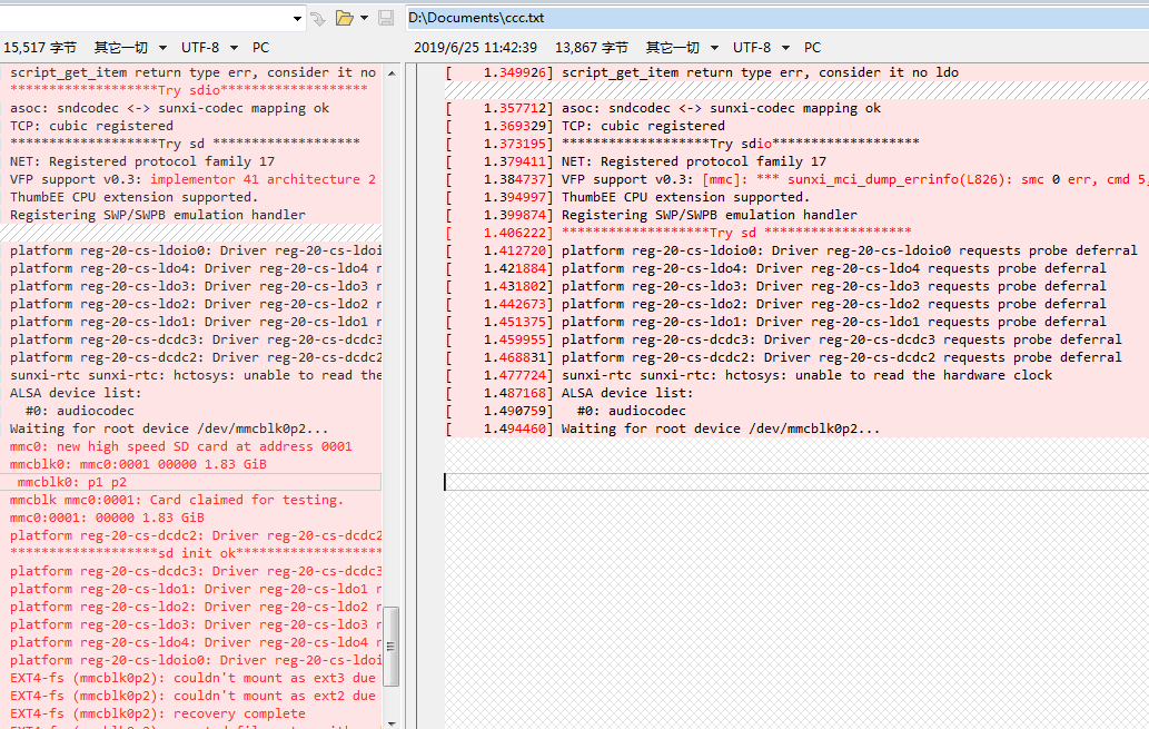

跪求大神们帮忙看看, 我进不去内核是怎么回事
starting USB...
No controllers found
switch to partitions #0, OK
mmc0 is current device
Scanning mmc 0:1...
Found U-Boot script /boot.scr
reading /boot.scr
290 bytes read in 18 ms (15.6 KiB/s)
reading uImage
Invalid FAT entry
262144 bytes read in 31 ms (8.1 MiB/s)
reading script.bin
Invalid FAT entry
2048 bytes read in 20 ms (99.6 KiB/s)
## Booting kernel from Legacy Image at 41000000 ...
Image Name: Linux-3.4.39
Image Type: ARM Linux Kernel Image (uncompressed)
Data Size: 2451016 Bytes = 2.3 MiB
Load Address: 40008000
Entry Point: 40008000
Verifying Checksum ... Bad Data CRC
ERROR: can't get kernel image!
SCRIPT FAILED: continuing...
starting USB...
USB is stopped. Please issue 'usb start' first.
starting USB...
No ethernet found.
missing environment variable: pxeuuid
No ethernet found.
No ethernet found.离线

找到问题了,是sys_config.fex没配置好

添加uboot和uimage,在uboot加上boot.scr的内容可以启动内核,但是识别不了文件系统

[ 1.409071] Kernel panic - not syncing: VFS: Unable to mount root fs on unknown-block(0,0)
[ 1.418402] Backtrace:

我不是TF卡启动,所以没用/dev/mmcblk0p2这个设备节点啊,而且我刚开始是有加这个的,会一直提示等待
内核识别到分区了,但是还是不行

[ 1.449386] Waiting for root device /dev/mmcblk0p2...离线

[ 1.324103] *******************Try sdio*******************
[ 1.330664] asoc: sndcodec <-> sunxi-codec mapping ok
[ 1.338616] TCP: cubic registered
[ 1.342516] NET: Registered protocol family 17
[ 1.347655] *******************Try sd *******************
[ 1.353919] VFP support v0.3: implementor 41 architecture 2 part 30 variant 7 rev 5
[ 1.362733] ThumbEE CPU extension supported.
[ 1.367605] Registering SWP/SWPB emulation handler
[ 1.377692] platform reg-20-cs-ldoio0: Driver reg-20-cs-ldoio0 requests probe deferral
[ 1.386776] platform reg-20-cs-ldo4: Driver reg-20-cs-ldo4 requests probe deferral
[ 1.395448] platform reg-20-cs-ldo3: Driver reg-20-cs-ldo3 requests probe deferral
[ 1.404098] platform reg-20-cs-ldo2: Driver reg-20-cs-ldo2 requests probe deferral
[ 1.412657] platform reg-20-cs-ldo1: Driver reg-20-cs-ldo1 requests probe deferral
[ 1.421308] platform reg-20-cs-dcdc3: Driver reg-20-cs-dcdc3 requests probe deferral
[ 1.430144] platform reg-20-cs-dcdc2: Driver reg-20-cs-dcdc2 requests probe deferral
[ 1.438920] sunxi-rtc sunxi-rtc: setting system clock to 1970-01-01 00:01:05 UTC (65)
[ 1.449281] ALSA device list:
[ 1.452760] #0: audiocodec
[ 1.456471] Waiting for root device /dev/mmcblk0p2...
[ 1.469385] mmc0: new high speed SDHC card at address aaaa
[ 1.476072] mmcblk0: mmc0:aaaa SC16G 14.8 GiB
[ 1.485689] mmcblk0: p1 p2
[ 1.489666] mmcblk mmc0:aaaa: Card claimed for testing.
[ 1.495716] mmc0:aaaa: SC16G 14.8 GiB
[ 1.500129] platform reg-20-cs-dcdc2: Driver reg-20-cs-dcdc2 requests probe deferral
[ 1.508967] platform reg-20-cs-dcdc3: Driver reg-20-cs-dcdc3 requests probe deferral
[ 1.517717] *******************sd init ok*******************
[ 1.524252] platform reg-20-cs-ldo1: Driver reg-20-cs-ldo1 requests probe deferral
[ 1.532871] platform reg-20-cs-ldo2: Driver reg-20-cs-ldo2 requests probe deferral
[ 1.541510] platform reg-20-cs-ldo3: Driver reg-20-cs-ldo3 requests probe deferral
[ 1.550146] platform reg-20-cs-ldo4: Driver reg-20-cs-ldo4 requests probe deferral
[ 1.558671] platform reg-20-cs-ldoio0: Driver reg-20-cs-ldoio0 requests probe deferral
[ 1.572931] EXT4-fs (mmcblk0p2): couldn't mount as ext3 due to feature incompatibilities
[ 1.584719] EXT4-fs (mmcblk0p2): couldn't mount as ext2 due to feature incompatibilities
[ 1.603803] EXT4-fs (mmcblk0p2): mounted filesystem with ordered data mode. Opts: (null)
[ 1.612994] VFS: Mounted root (ext4 filesystem) on device 179:2.
