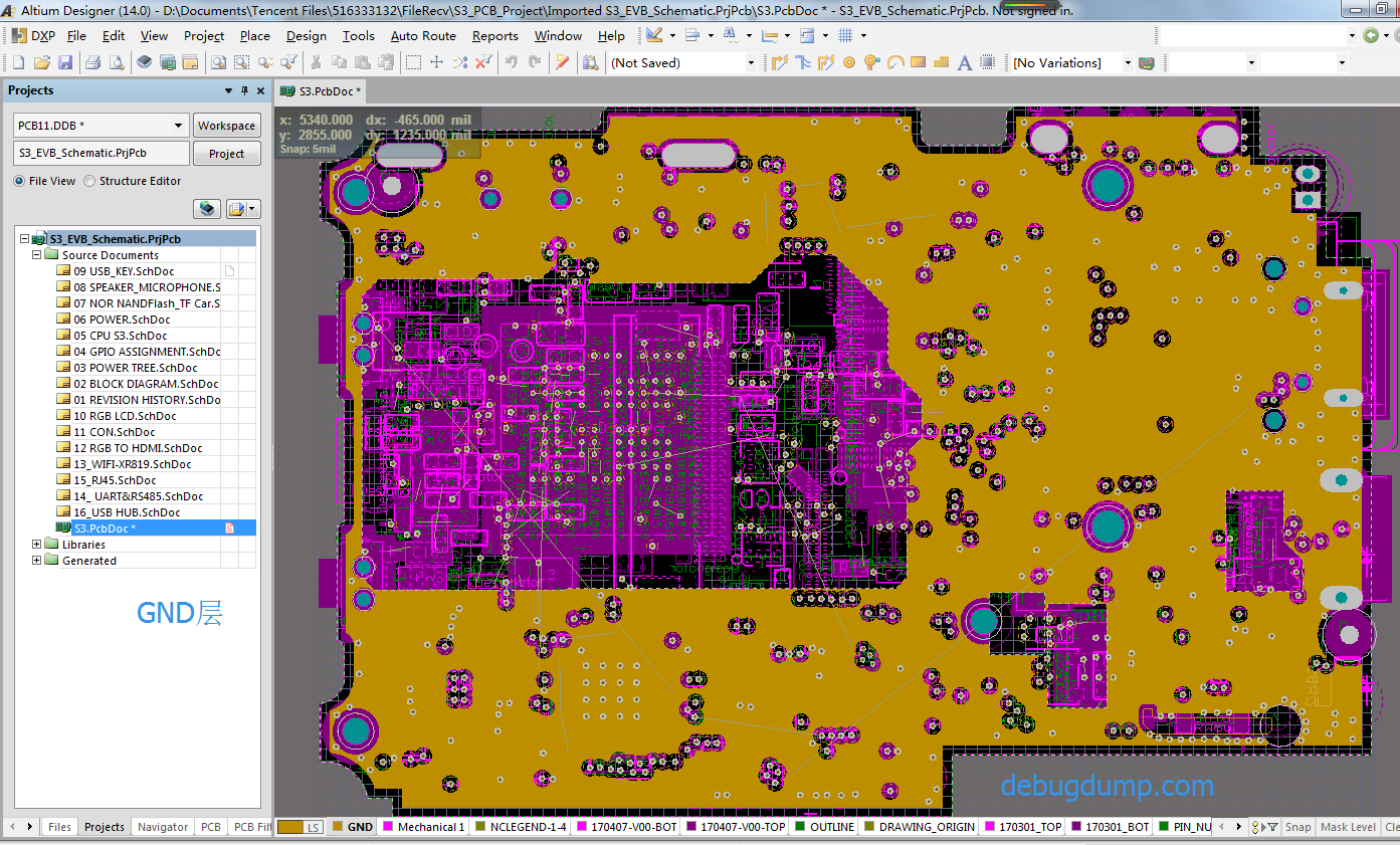

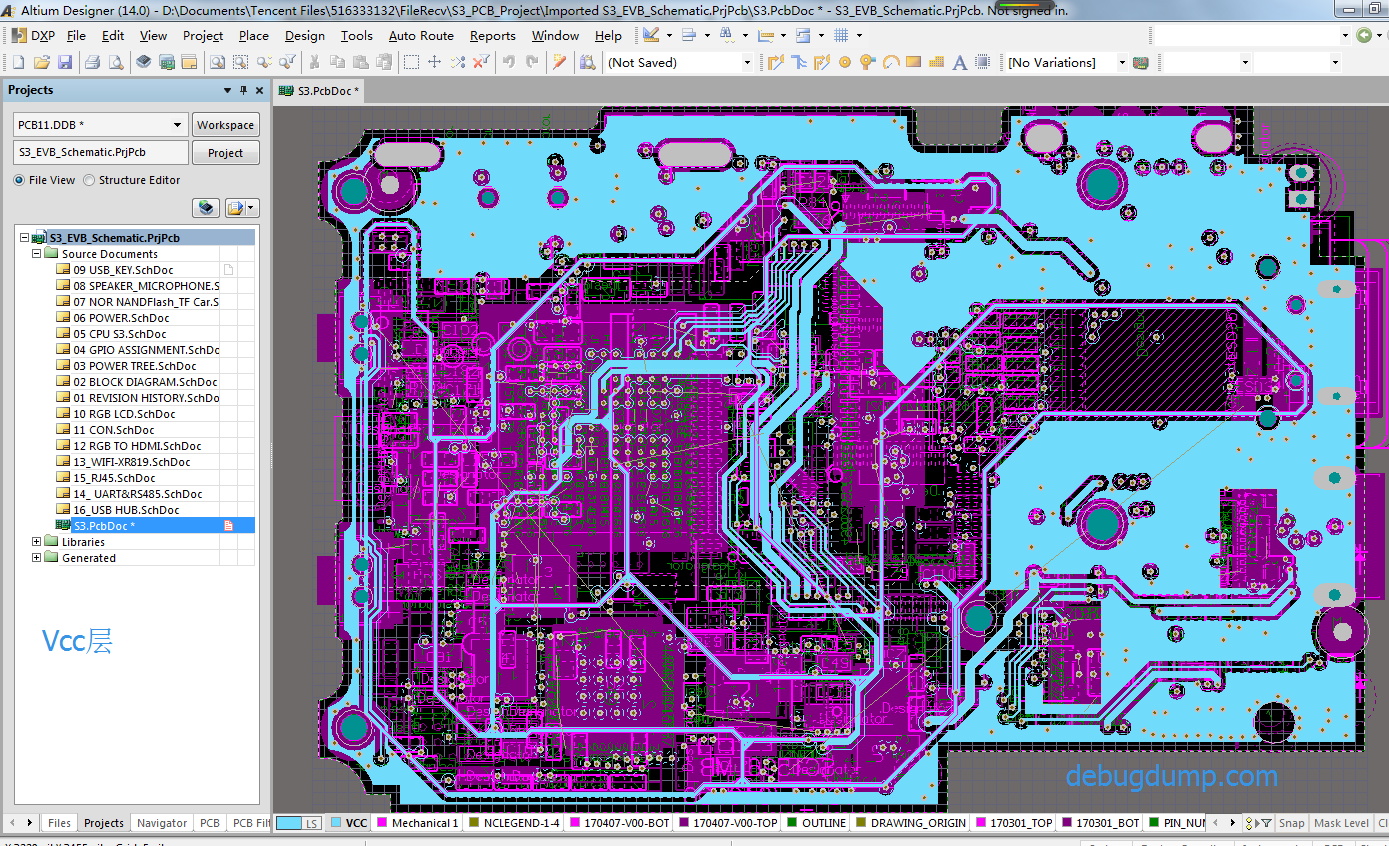

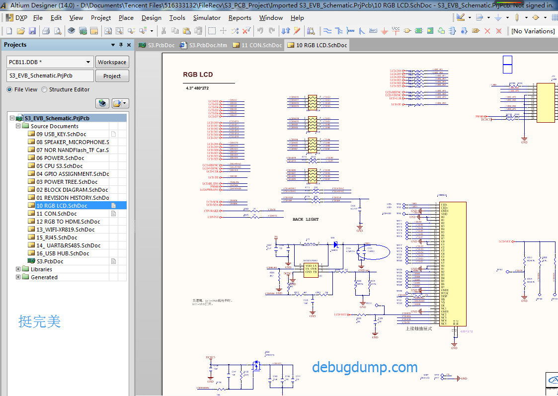

编译索智(Sochip) S3 SDK (zeta) 【提供DXP格式原理图与PCB,感谢 @playflash】

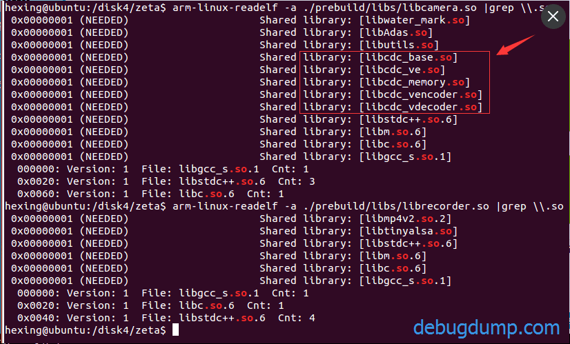

社区逆向出来的编解码器资料: https://github.com/allwinner-zh/media-codec

S3的SDK是基于Linux,而不是Camdroid框架, 值得研究。

DXP格式原理图与PCB下载: S3_PCB_Project.7z
感谢debugdump网友 @playflash !!!

V3s camdroid 的资料: https://github.com/qq516333132/camdroid
这是 camdroid 编解码器依赖的库文件:
https://github.com/qq516333132/camdroid/tree/master/camdroid/frameworks/av/media/CedarX-Projects/CedarAndroidLib/LIB_JB42_F81
libadecoder.so
libcdx_base.so
libcdx_parser.so
libcdx_stream.so
libcedarx_aencoder.so
libcedarxbase.so
libcedarxplayer.so
libMemAdapter.so
libnormal_audio.so
libsdecoder.so
libvdecoder.so
libvencoder.so
libVE.so
上面这些库文件,在S3 SDK基本都找不到, 不知道如何实现编解码的.

V3s zeta SDK 使用的库:
hexing@ubuntu:/disk4/zeta/prebuild/libs$ ls -l
total 3152
-rwxrwxr-x 1 hexing hexing 1791461 Sep 12 14:02 libAdas.so
-rwxrwxr-x 1 hexing hexing   88992 Sep 12 14:02 libaw_net.so
-rwxrwxr-x 1 hexing hexing  409848 Sep 12 14:02 libcamera.so
-rwxrwxr-x 1 hexing hexing    4444 Sep 12 14:02 libcdc_base.so
-rwxrwxr-x 1 hexing hexing   16564 Sep 12 14:02 libcdc_memory.so
-rwxrwxr-x 1 hexing hexing   78012 Sep 12 14:02 libcdc_sdecoder.so
-rwxrwxr-x 1 hexing hexing   27028 Sep 12 14:02 libcdc_vd_avs.so
-rwxrwxr-x 1 hexing hexing   94668 Sep 12 14:02 libcdc_vdecoder.so
-rwxrwxr-x 1 hexing hexing  125112 Sep 12 14:02 libcdc_vd_h264.so

hexing@ubuntu:/disk4/zeta$ arm-linux-readelf -a ./prebuild/libs/libcamera.so |grep \\.so
0x00000001 (NEEDED) Shared library: [libwater_mark.so]
0x00000001 (NEEDED) Shared library: [libAdas.so]
0x00000001 (NEEDED) Shared library: [libutils.so]
0x00000001 (NEEDED) Shared library: [libcdc_base.so]
0x00000001 (NEEDED) Shared library: [libcdc_ve.so]
0x00000001 (NEEDED) Shared library: [libcdc_memory.so]
0x00000001 (NEEDED) Shared library: [libcdc_vencoder.so]
0x00000001 (NEEDED) Shared library: [libcdc_vdecoder.so]
0x00000001 (NEEDED) Shared library: [libstdc++.so.6]
0x00000001 (NEEDED) Shared library: [libm.so.6]
0x00000001 (NEEDED) Shared library: [libc.so.6]
0x00000001 (NEEDED) Shared library: [libgcc_s.so.1]
000000: Version: 1 File: libgcc_s.so.1 Cnt: 1
0x0020: Version: 1 File: libstdc++.so.6 Cnt: 3
0x0060: Version: 1 File: libc.so.6 Cnt: 1
hexing@ubuntu:/disk4/zeta$ arm-linux-readelf -a ./prebuild/libs/librecorder.so |grep \\.so
0x00000001 (NEEDED) Shared library: [libmp4v2.so.2]
0x00000001 (NEEDED) Shared library: [libtinyalsa.so]
0x0020: Version: 1 File: libc.so.6 Cnt: 1
0x0040: Version: 1 File: libstdc++.so.6 Cnt: 4
由此可见,zeta 弄了个 libcamera.so 封装了全志的库 libcdc*.so

楼主 #88 2019-09-30 19:53:44
已发帖子: 9,473
Re: 编译索智(Sochip) S3 SDK (zeta) 【提供DXP格式原理图与PCB,感谢 @playflash】
可能某些层的显示被我disable了
#89 2019-09-30 20:33:49
晕哥小弟
注册时间: 2019-04-04
已发帖子: 311
积分: 301.5
要不重新上传一份呗.
楼主 #90 2019-09-30 20:51:00
已发帖子: 9,473
图层设置一下就好了
#91 2019-09-30 21:12:56
晕哥小弟
注册时间: 2019-04-04
已发帖子: 311
积分: 301.5
不明白你中间层GND,为什么不整个铺满 ?
楼主 #92 2019-09-30 21:36:34
已发帖子: 9,473
或许设计就是这样,或许转换的时候丢了
